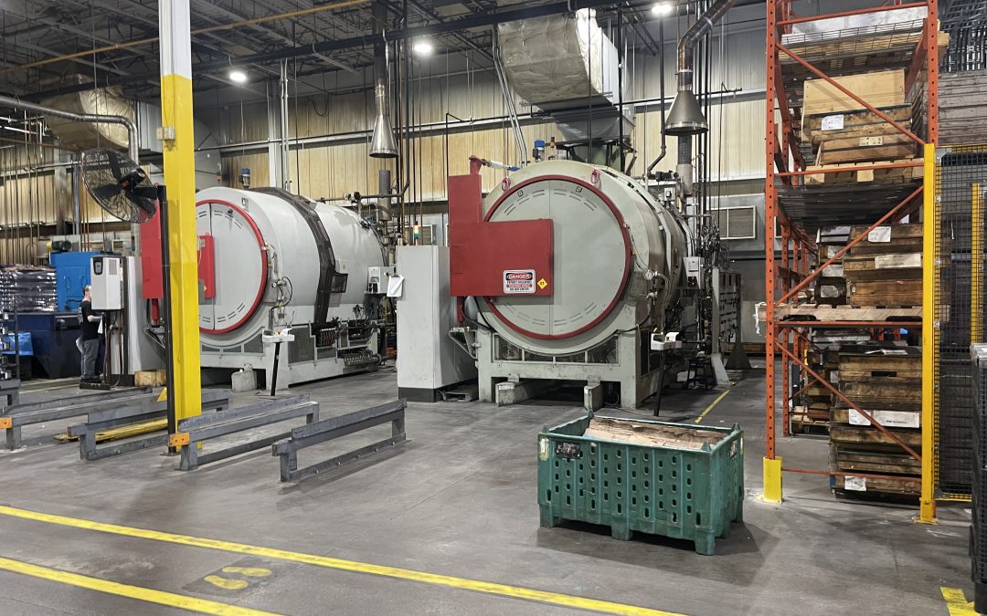

Yesterday we had a news item about Solar Atmospheres in South Carolina, USA installing a vacuum furnace as we speak. Well this is what it looks like now partway through being installed.
Solar Atmospheres receives a 12 foot horizontal, car bottom-loading vacuum furnace, capable of processing up to 50,000 lbs of material. Below you can see the original tweet from Solar Manufacturing along with the video of them shipping the furnace.
