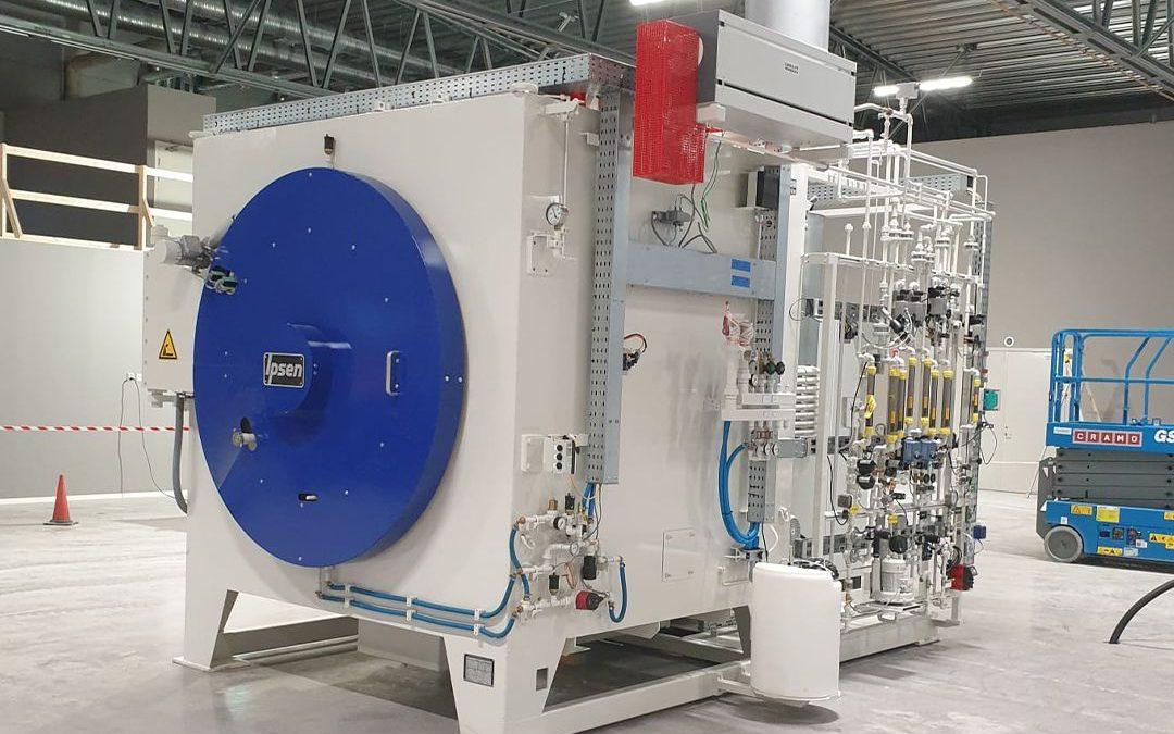

Bati Heat Treat in Monterrey, Mexico just installed and commissioned a new gas nitrider from German furnace builder KGO this week. Bati is a commercial heat treater headquartered in Izmir, Turkey-the Mexico facility was inaugurated in 2018.  The company now has 5 of these systems, 4 in Turkey and this one in their Monterrey facility. In this photo we see Ilker Seymen and Manager of the company.
Bearing manufacturer and captive heat treater JTEKT in Bedford, Quebec recently found that they had surplus heat treating capacity and the end result was that they elected to sell off a batch IQ furnace. The 36 X 48 X 36″ furnace was originally built by Williams Industrial Services of Bowling Green, Ohio, USA (whose ad can be found on this page) back in 2005 but had never seen much used over the years. The furnace ended up at another Canadian company.
