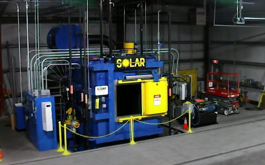

Solar Manufacturing Inc., Sellersville, Pa. announces the receipt of US Patent No. 11053560 issue date July 6, 2021. The patent covers the use of a full isolation power transformer for use with a 600 HP 460 volt motor, and with an ionizing gas, such as Argon, to prevent electric motor ground fault and failure, with additional solid state circuit protection, in conjunction with a vacuum furnace gas quench system. Full details will be on the US Patent Office website after July 6, 2021.

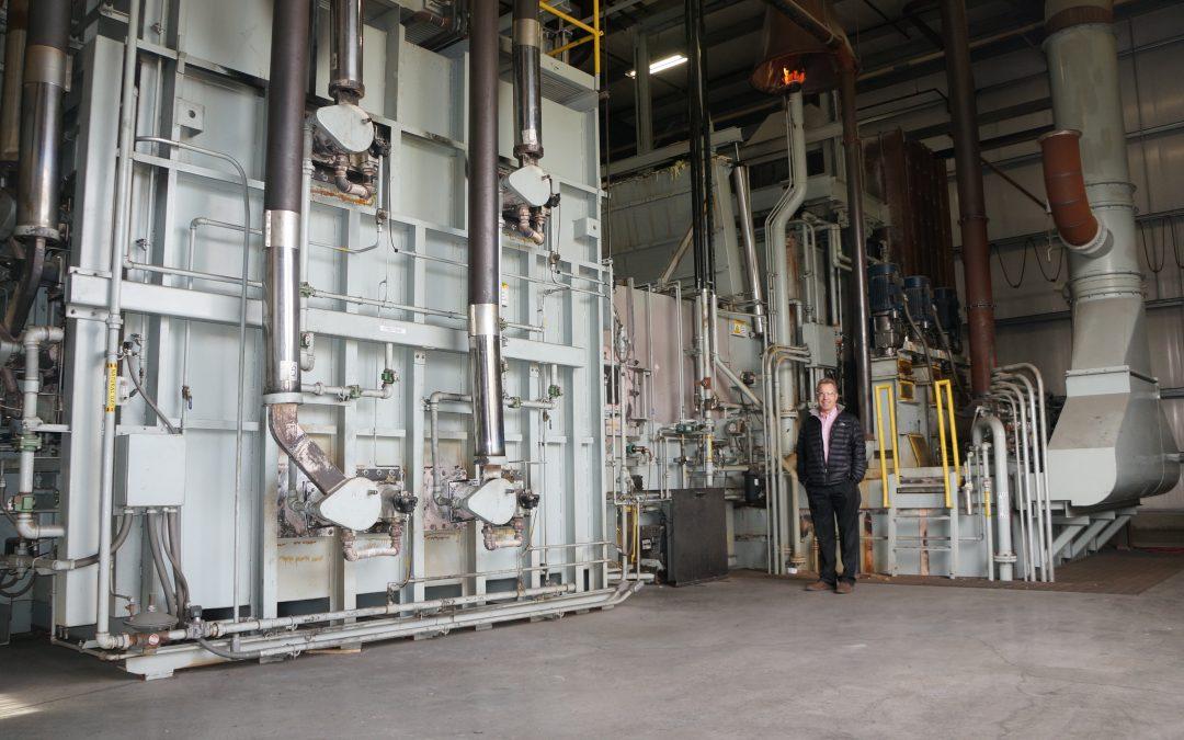

Almost exactly one year ago Nitrex Heat Treating Services announced that they would be installing a new vacuum carburizing system provided by ECM at their Illinois, USA location (to learn how Nitrex compares in size to other North American heat treaters we would suggest this list as compiled by “The Monty Heat Treat News”https://themonty.com/project/largest-north-american-commercial-heat-treats-august-2020/ ).  Today we learn that the installation is almost complete as can be seen in this photo provided by Nitrex.
“July 2020 Press Release; Jason Orosz, President of Nitrex Heat Treating Services, announced a new plant investment aimed at expanding the Aurora, Illinois commercial heat treat facility located just west of Chicago. The production expansion will add a fourth building on the property to house a new low-pressure carburizing (LPC) system and secondary heat-treating equipment.
The new ECM vacuum carburizing furnace with oil quench capabilities will help meet growing demand from makers of high-end critical parts within the automotive, aerospace, and tooling industries. The 20-bar dual-chamber furnace has a workload size of 40″ L x 24″ W x 28″ H (1000 x 600 x 715 mm) and a load capacity of 1500 lbs. (680 kg).
Nitrex will break ground on the new building on July 20, which will connect to an existing structure, Building 3. According to Bill Walter, Facility Manager of Nitrex Aurora, the construction project will be completed in January 2021, and production on the LPC furnace is expected to begin in April 2021. The expansion will increase the production footprint by 11,000 square feet, a pre-requisite to support current demand as well as future growth. Once this building is completed, the total floor space will be over 50,000 square feet.
Nitrex first put down its roots in Aurora, Illinois in 2000, after acquiring Alliance Metal Treating from owner Tom Cooper, who stayed on following the acquisition to run operations and to help position the company for future growth. Initially, the plant offered heat treating processes focusing on annealing, carburizing, carbonitriding, neutral hardening, and normalizing. During the preceding decades of expansion, NitregR nitriding and NitregR-S nitrocarburizing capabilities were added to its production operations; the larger footprint also supported more vacuum carburizers, tempering furnaces, and post-finishing equipment.
