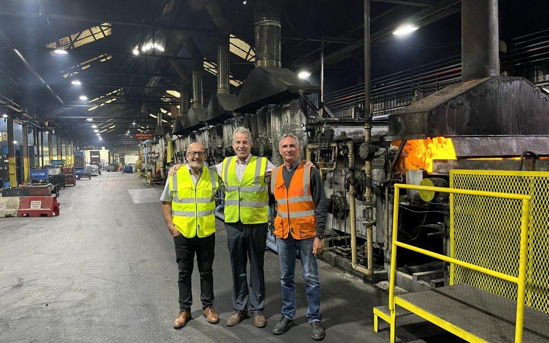

Founded in 1946 Stack is owned and operated by the Ederer family with Doug Puerta as CEO (as an interesting little footnote Doug’s father Ralph owns Vacu-Braze in PA, which is where Doug got his start in the heat treating industry). “The Monty Heat Treat News” has had the opportunity to visit Stack several times over the years and have always been impressed that the company is willing to make substantial investments in new equipment and technologies if the ROI appears to make sense. Case in point is the fact that in early 2020 Stack opened a new facility in Albany, Oregon dedicated to “Hot Isostatic Pressing”-one of these photos shows the grand opening.
One of our favorite photos of Stack shows another major investment made not that long ago-two very substantial bottom loading vacuum furnace, all experienced vacuum heat treaters will realize that this was a multi-million dollar project.
