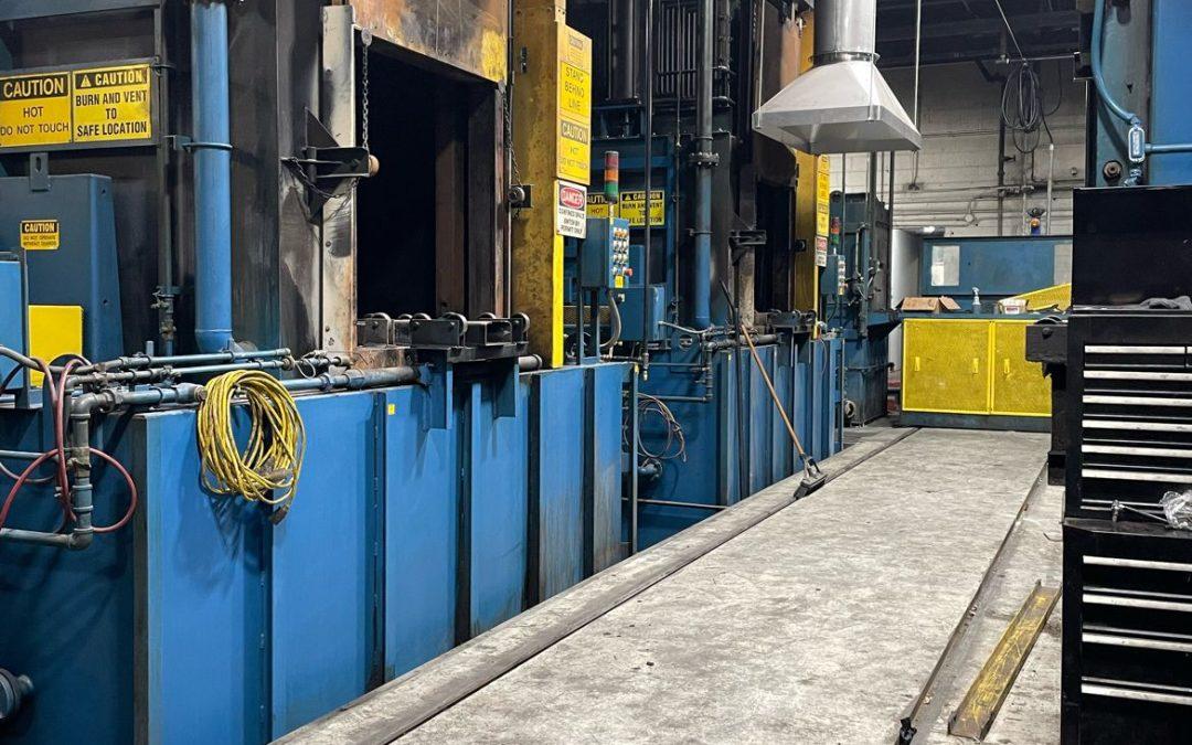

All of the equipment at what was formerly “Metal Ceramics Company” of Bensenville, Illinois, USA will shortly be going to auction-this includes the entire heat treating department. In addition to the continuous furnaces the auction will also include machinery, customer lists and intellectual property. The auction will be held September 21. 2022 and amongst the heat treating equipment included is aa Abbott 18″ Electric Furnace (converted from gas), a Sinterite 12” belt sintering furnace and a pusher line. Metal Ceramics Company was founded in 1951 and offered powdered metal parts to a variety of industries including the automotive industry. “The Monty Heat Treat News” would expect to see some interest in the furnaces but not a lot considering the age and condition.
A captive heat treater has shut down his entire batch IQ heat treatment department and all of the equipment is available. Equipment consists of the following;
Some alloy fixturing and spare parts also available. Both lines shut down very recently, still installed. Very good condition ready to go. Vendor prefers to sell entire department as one package but will consider selling some items separately. Further details available upon request.
