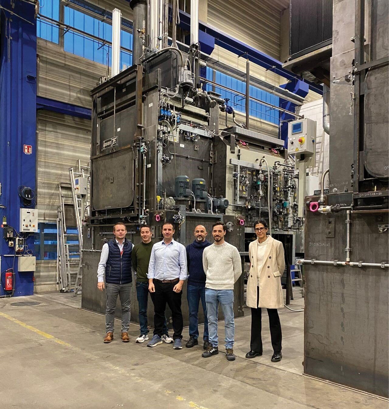

Over the years “The Monty Heat Treat News” has reported several times on a large captive/commercial heat treater in Ovar, Portugal by the name of Ramada S.A. The last time we mentioned the firm was November of 2023 when we spoke about the company investing in 2 new sealed quench furnaces being provided by Ipsen of Kleve, Germany. The installation is now complete as we can see in this photo and the press release below.

“NOVEMBER 22/2023; Captive Heat Treater Prepares to Receive New Sealed Quench Furnaces; The Monty Heat Treat News has spoken several times about captive/commercial heat treater Ramada S.A. in Ovar, Portugal-as a matter of fact Gord and Dale Montgomery visited this facility in 2021 (you can read our summary of that visit further down).
As we have previously reported the company recently invested in two brand new Ipsen Sealed Quench furnaces (Batch IQ furnaces to our North American readers)-the project involves 2 Ipsen-RTQF-XL-GRM furnaces with all the ancillary items required. The furnaces are now completed at Ipsen in Kleve, Germany and prior to shipping Ipsen hosted the entire Ramada heat treat team for a week of training as you can see in this picture.
