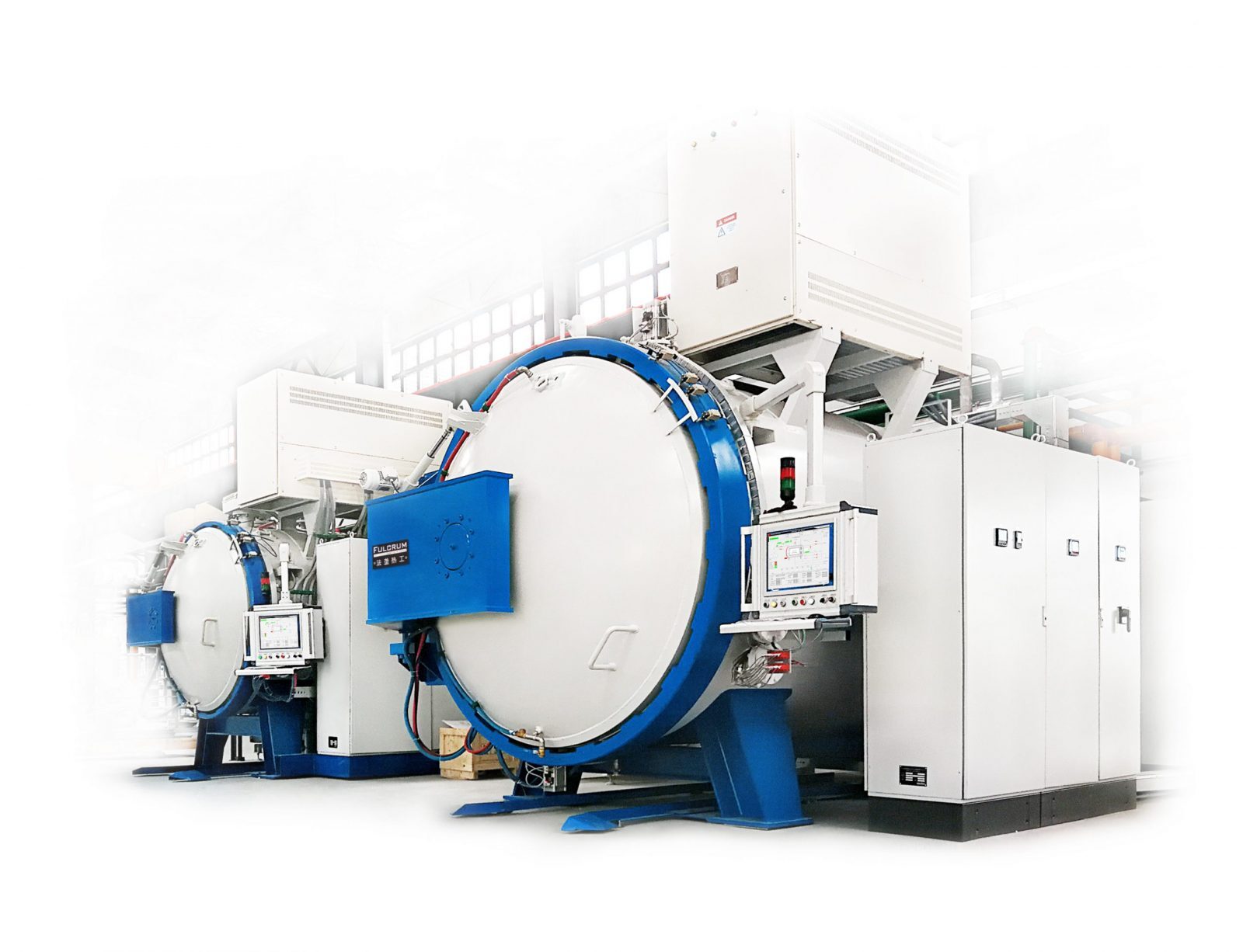

“Tecnotêmpera, a major service heat treater in the southeast of Brazil, acquired a heat treatment line for the heat treatment of tools, large dies and functional parts. The vacuum furnace in this line has the largest payload in Brazil, a gross load of 4000 kg. Its dimensions of 1000 x 1000 x 1500 mm (39’’x 59” x 39”) make it one of the largest furnaces in South America.
However, it is the largest single-chamber low-pressure carburising vacuum furnace in South America. The complete semi-automatic line, which consist of a vacuum furnace, an annealing furnace, a tempering furnace, manually operated forklifts and a supervisory software, will start operation in the second half of 2020. Fulcrum, a Chinese furnace manufacturer and one of the leading technological companies in heat treatment equipment in Asia, supplies the equipment. Tecpropro is the South American representative of Fulcrum.
