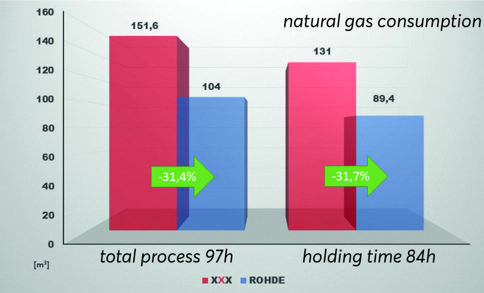

JR: We have a very current practical example of the energy efficiency of our systems. We have supplied a new customer from the Stuttgart area with gas-heated gas nitriding systems of type KGU 100/120/180. Since this customer has already operated and operates gas nitriding systems from other manufacturers, he wanted to convince himself of the efficiency of our systems. Already in the decision-making process, the customer took the opportunity to visit the plant and to have his new plant presented by us down to the smallest detail on the basis of a 3D-model. We were able to explain our solutions to him in detail and take away his concerns about existing problems. The operation of the systems shows that our efforts have paid off.
HTM: Can you give us exact numbers?
JR: Our customer can quantify the savings exactly as he records the consumption values of all his systems. The special thing is that in this case we were able to compare our systems directly with those of a market competitor. Within a few days, the customer had run a comparison batch with the same batch content and the same process. The systems both have an external cooling unit from the same manufacturer, so the electricity costs should not be underestimated and provide us with information about the amount of energy that has to be used as cooling capacity. You can see the exact numbers from the graphics. In this case, according to our customer, this saves more than €10,500 per year in operating costs per system. Over the service life of such a system, our systems pay for themselves through this effect alone.
HTM: Of course, this gives you an enormous advantage in this day and age. What do you think is the cause of this increase in efficiency?
JR: Energy efficiency has always been an issue for us, because those who waste energy unnecessarily give away their money. Today, our customers are faced with the challenge of profitable production, even though costs continue to rise and this trend is expected to continue. We took this problem on board years ago and optimized our products so that our customers can save energy costs. Without going into too much detail, everyone can easily see the difference between our systems. Take a look at the external

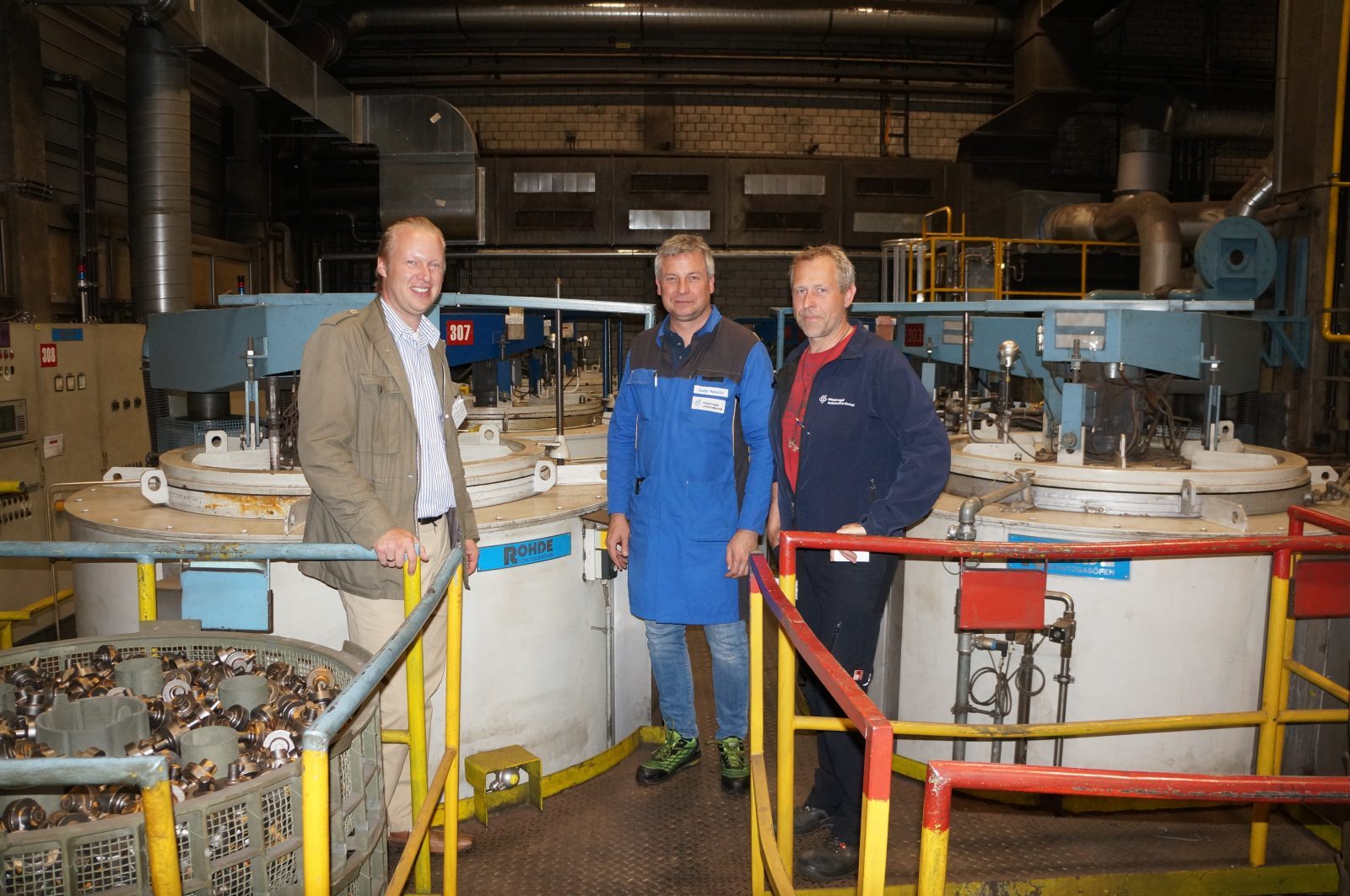

 Joern Rohde (left) Hirschvogel Automotive Group, Denklingen, Germany
