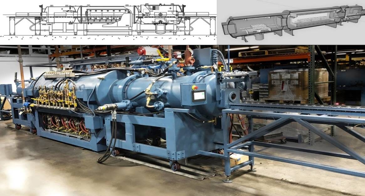

"Gasbarre Thermal Processing Systems is pleased to announce the recent shipment of a Continuous Vacuum Furnace with 10 BAR pressure quench capabilities to a major aerospace manufacturer in North America. The 4 position, 4 zone furnace is rated to 2400°F. The independent load and quench modules allow the heat module to hold temperature and vacuum creating an extremely pure environment. Extended heating element coverage allows for excellent temperature uniformity. As only the workload is cooled in the isolated cooling chamber, it makes for a very efficient system. Quick transference from the heat module to the cool module and fast quench capabilities make this an ideal vacuum furnace to process medium to high volume parts. Gasbarre was chosen as the equipment supplier based on proven performance from past projects with this manufacturer, as well as, extremely low down time metrics with their existing Gasbarre vacuum furnace equipment.
