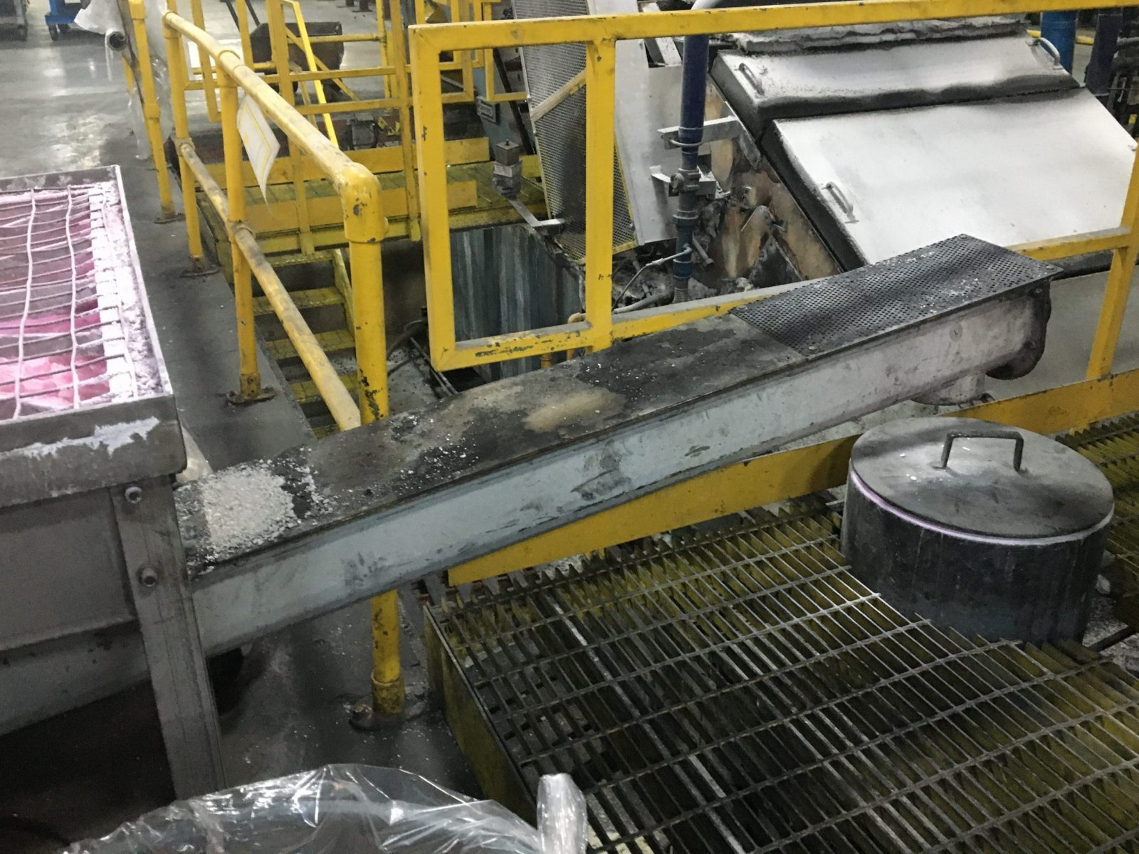

It was such a terrible, avoidable death that we at “The Monty” have never forgotten the accident or the details. Fast forward to 2020 and we saw a simple, very ingenious system which would totally eliminate the chance of this sort of accident ever happening again.
What we witnessed at a captive heat treater with several mesh belt austemper lines was a completely automated system for adding salt to a molten salt bath. It consists of a vibrating hopper into which the bags of new salt are added (the vibrating feature is to break up the salt), the hopper feeds a small enclosed conveyor which delivers the salt into the covered tank through a 12″ diameter tube. The system allows the salt to be added without the quench tank ever being uncovered and completely eliminates the chance of anything falling into the tank and also eliminates the chance of “splash back”. The photo below shows the system. A simple ingenious idea which would have prevented a needless death.
