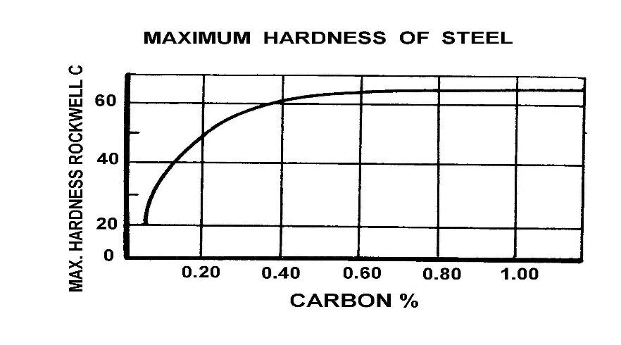

The following illustration shows the effects of carbon in a plain carbon steel. It further shows the importance and effects the quench medium and the transformation of austenite to martensite. Please remember that this is for a plain carbon steel, not an alloy steel or tool steel. The top line displays the hardness results based on a good transformation to martensite, and the bottom line shows the effects of only 50% transformation from austenite to martensite.
The previous illustration (shown above indicates) the approximate maximum hardness achievable despite the increase in carbon % above approximately 0.65The following illustration once again shows, the principle alloying elements that are typically added to the steel ladle when the steel is being made.
