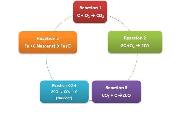

The carburizing container (that is filled with the carburising granulate) will always contain air. When heat is applied, the air will interact with the carburising granulate and release both nitrogen and oxygen under thermal conditions.
At the selected process temperature and the approach up to the process temperature, the thermal condition will cause the oxygen to react with the carbon to form carbon monoxide.
Once again due to the thermal conditions the carbon monoxide will react with the steel surface to be carburized and release nascent/atomic carbon plus carbon dioxide. It is the nascent carbon that is diffused into the surface of the steel component shown in the following reaction sequence.
Surface Reactions during the Pack Carburizing Process.

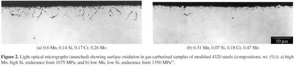

Internal Potential Contamination by Grain Boundary Oxidation of the New Charge Being Processed.
When pack carburizing it must always be remembered that the presence of oxygen within the process retort is being derived from the decomposition of air that is initially present in the process box. This will give rise to the formation of intergranular oxidation, (or grain boundary oxidation, GBO). The depth of the oxidation will depend on the process cycle time in relation to the case depth required. Obviously, the deeper the case depth, the deeper the GBO.
An example of Inter Granular Oxidation

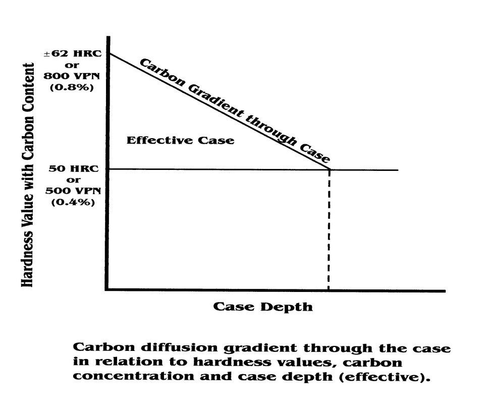

The depth of formed case must be tested for hardness after quenching. (Note: after quenching for the hardening procedure of the newly formed case).
Depending on the selected load on the hardness test machine will determine if carburizing has taken place or if the indenter has pierced the formed case and is giving an average reading between case and core.  Therefore it is strongly recommended that a cross sectional traverse hardness plot be given to accurately establish the    total depth of newly formed case.
The depth of carbon penetration is (as previously described is a function of time and temperature in order to diffuse the carbon into the steel surface.
The depth of hardness penetration will be dependent on the carbon content of the carburized layer. Provided that only martensite is formed in the case when quenched, the depth of case hardening would be equivalent to a depth of carbon penetration down to 0.4 % carbon.

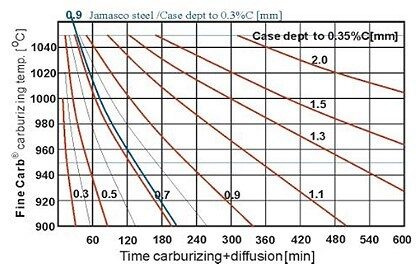

Based on the Harris formula, the following approximate values can be used to approximate the process cycle time at a  process temperature of 1650°F up to 1700°F.
The values given below are  based upon the Harris Formulae and a plain carbon steel, shown as follows:
Case Depth = 0,016”    T at 1550° F
Case Depth = 0,018”    T at 1600° F
Case Depth = 0,021”    T at 1650° F
Case Depth = 0,025”    T at 1700° F
Case Depth = 0,030”    T at 1750° F
Case Depth = 0,036”    T at 1800° F
Case Depth = 0,043”    T at 1850° F
Case Depth = 0,051”    T at 1900° F
