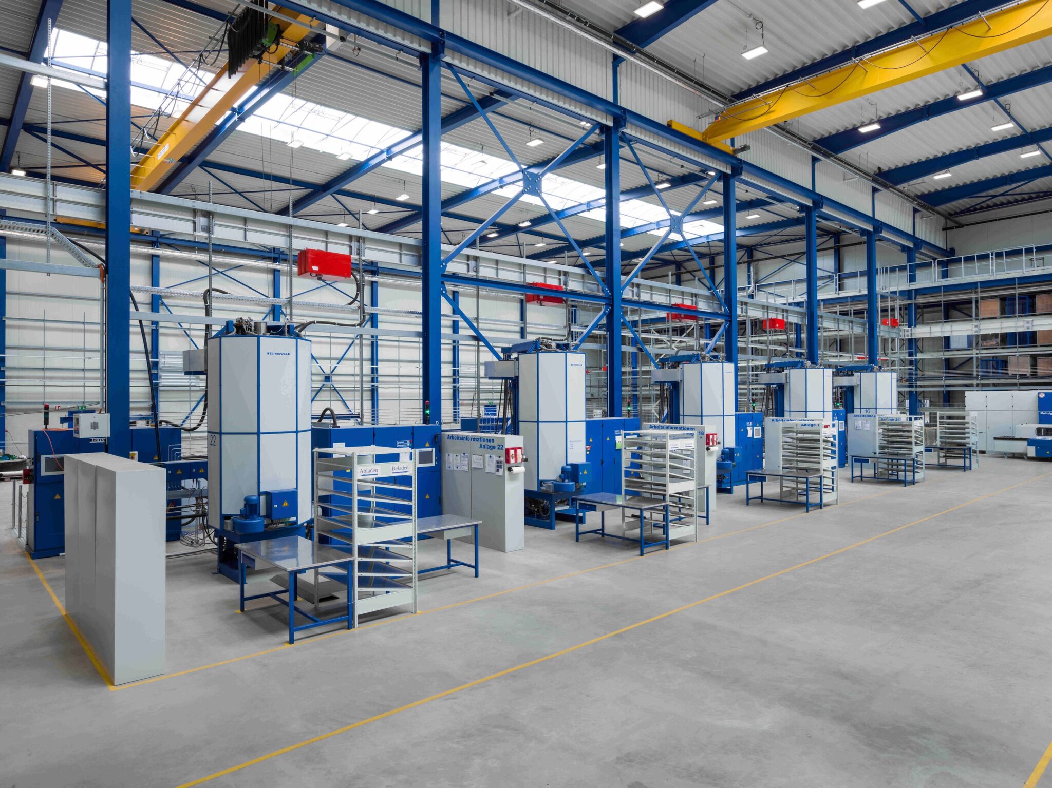

“Let’s start with our business. Eltropuls is a family-owned business which started to build plasma nitriding units almost 45 years ago! Since this time, we have continuously developed the technology. We ourselves are running 40 plasma nitriding units in our heat treatment shops. Therefore, we know how the furnaces work and how to treat components and we are happy to provide this know-how to our customers.

“The biggest leap in technology was when we introduced the pulsed process right at the start. Since then, we have continuously improved the process mainly in two areas. One focus is on efficiency and ease of use. Modern systems need much less energy, gas and maintenance than the original systems. The second area is on size and integration of other surface technologies. We have delivered plasma nitriding systems of up to 6,4 m diameter and above 5 m in height. Also, recently we also integrated PVD Coating into the same technology platform as the nitriding.”
