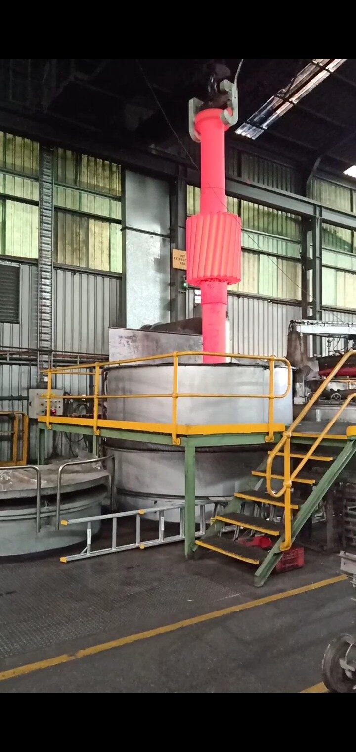

Hofmann Engineering owns four large factories in Australia as well as factories in North and South America. In Perth, the company headquarters, the company has a large heat treatment operation: Our largest is a carburising furnace with working chamber of 1.9m diameter and 4.8m deep from Aichelin. Other carburising and nitro carburising furnaces are 0.9m diameter x 1.8m deep, 0.6m diameter x 0.8m deep and 2 off 0.3m diameter x 0.6m deep in the form of fluid bed furnaces by quality heat treatment.
The Perth facility also made significant investment into induction hardening with a complete ABB robotic induction hardening cell, 1 off EMA tooth by tooth gear hardener, 1 off large capacity Radyne pin hardener and 2 off variable frequency induction hardeners. We also have a large portable induction hardening unit for re- hardening rope drums in situ. Finally in the heat treatment area we have an assortment of quench and temper, cryogenic, salt bath, draw furnace, blackening and shot blast.
In the fabrication area we have extremely large PWHT and stress-relieve furnaces in the form of a top hat 4.6m diameter x 2m high and a box furnace 14m x 14m x 4m high. Our eastern state factories in Bendigo and Newcastle have specialist PWHT for railway bogies on a large scale among other smaller heat treatment capabilities. One limitation I can see is that manufacturing costs relatively high in Australia due to factors like power, labour and geographically long supply chains. Having said that, Hofmann Engineering competes globally with up to 50% of sales for export.
