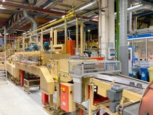

“Retrofit of 5 Roller Hearth Furnaces Increases Production Reliability and Performance. Retrofitted AICHELIN roller hearth furnaces (© AICHELIN Service GmbH). Mödling/Ludwigsburg/Lüchow (ptp/22.03.2023/08:00) –
SKF GmbH produces different roller bearing products in their plant in Lüchow in Lower Saxony. For the heat treatment of their parts, they have been using AICHELIN plants and services for decades. SKF commissioned AICHELIN Service with an extensive modernization of five of those plants in 2022. With the successful recommissioning of the plants in late December 2022, SKF has fully achieved its project goals: to guarantee production reliability, and to significantly increase productivity.
SKF has been an AICHELIN customer since the 1980s and has nine AICHELIN roller hearth furnaces for the heat treatment of roller bearings at their Lüchow site. The outdated electronic control system Siemens SPS S5 and hence the necessary conversion to the failsafe Simatic S7-1500 was the reason for this recent plant modernization. SKF decided to combine this upgrade of the control system with further retrofits and modernizations on their plants.
Significant Increase of Productivity and Flexibility

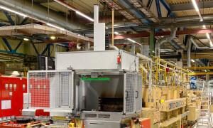

To increase the throughput of parts in the heat treatment plant, AICHELIN constructed a new stacking gantry, in cooperation with the SKF project team as well as with an external partner. This stacking gantry is being used for the first time at SKF and now enables the customer to run two to a maximum of three layers of roller bearings in a single heat treatment process instead of the previous single-layer process. In addition to expanding production capacity, this will also enable SKF to respond more flexibly to additional demand in the future and, above all, to utilize the capacity of the plants in a much more energy-efficient manner. FOCOS 4.0, AICHELIN’s Industry 4.0 application for monitoring and verifying the quality of process values, was also newly integrated.
AICHELIN Service Manages the Project as General Contractor
SKF decided early on to have AICHELIN Service plan and execute all the trades involved in the project, thus opting for the specialist expertise of the industrial furnace manufacturer. Having a ‘one-stop service’ was the decisive aspect: AICHELIN Service acted as general contractor and was responsible for the overall project management as well as the execution of the services of all partners and subcontractors involved. The conditions were challenging for the project partners: Originally, the project was scheduled to run from November 2021 to June 2022 and was considered time-critical because production reliability had to be ensured. The plants were to be converted step by step one after the other. However, due to the widespread supply bottlenecks along the supply chain in the market, there were several months of delivery delays for various parts.”
