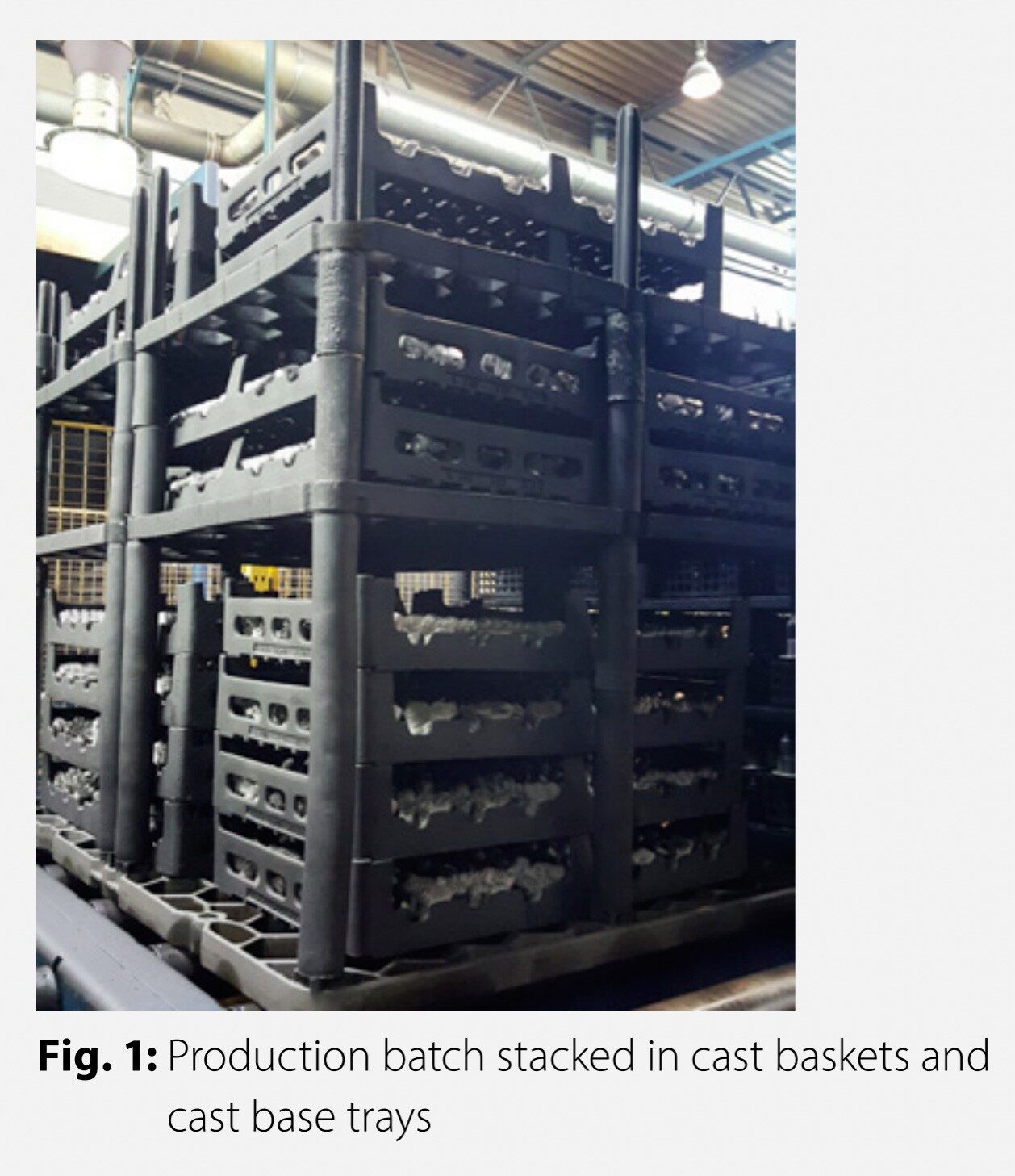

The drive component cited in this article is case hardened in a multi purpose chamber furnace. The surface/weight ratio is low and characterized by a solid cross-section in different sizes. Component distortions due to heat treatment are thus less critical and are not considered further. The largest component weighs about 500 g. Components are loaded in cast baskets, which are positioned on cast base trays (Fig. 1).
The existing production capacity is to be made available in full for the current order volume without additional plant investments and customer delivery dates are to be met. Production will take place in three-shift operation 7 days per week. A furnace campaign takes about 10 h and is limited by the weight of the maximum load capacity of the system of 1,500 kg. The cast loading systems used cannot increase the furnace capacity in pieces/batch. Based on experience gained internally with CFC (CFC = Carbon Fibre – reinforced – Carbon), a corresponding CFC fixture system is preferred. Compared with a cast fixture, the mass of the CFC fixture can be reduced significantly and this enables a larger number of components per batch (packing density); furnace loading with a maximum total mass of 1,500 kg (fixture and components) remains the decisive criterion.

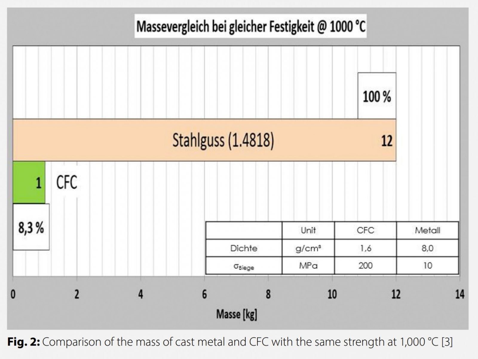

The assessment of specific strength in terms of the “load bearing capacity” of CFC and cast steel shows that, theoretically (component dependent), about 90 % of the fixture mass (“dead mass”) could be saved (Fig. 2).
Due to the lower density (CFC: 1.6 g/cm3 / cast steel: 8.0 g/cm3), the energy requirement of a CFC fixture when heated from room temperature to 1,000 °C is calculated to be about 1/5 of the comparable requirement of a cast fixture [2]. The combination of load bearing capacity and energy requirement in the CFC fixture promises a higher packing density and thus a higher furnace capacity. Compared to low-pressure carburizing with high-pressure gas quenching (N2, He), which takes place without oxygen, in the case of gas carburizing and subsequent oil quenching, the chemical degradation of CFC by oxidation is to be assessed. Above 350 °C, the CFC surface can be damaged by oxidation in air, so lowering the load bearing capacity. Based on HEAT’s own operating experience and extensive preliminary tests, a reasonable plant modification is needed at the exit of the batch. This ensures that the CFC is not exposed to any critical temperatures above 350 °C. Most oil residues are removed in the subsequent washing process. The solvent used does not affect the material. These results were a factor in the decision to use a CFC system.

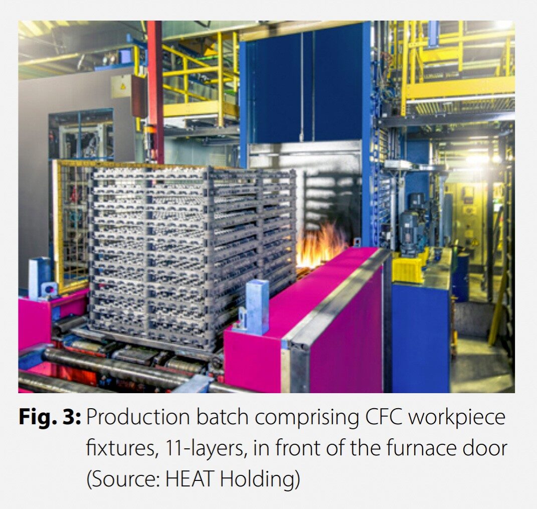

The process analysis defines the technical requirements of the CFC fixture. As a lift truck (forklift truck), connecting rods and transport chains are used for transportation, a cast base tray was selected as link (transport systems – casting – CFC). With the cast CFC material combination, the clearly different thermal expansion coefficients, particularly for the post system, have to be taken into account in the design. In a test series, the influence of gas carburizing, oil adhesion (quenching medium) to air at the chamber outlet, and the washing agent for cleaning were analyzed. The gas atmosphere and the washing process were not shown to have an effect on the material. However, with atmospheric oxygen, the unavoidable drops of oil on the workpiece fixture led to flame formation and thus to temperatures above 350 °C. With an additional measure to the heat treatment facility, this situation was reliably improved and maximum temperatures of 350 °C in air are ensured (Fig. 3).
Loading takes place at the stations already set up for this purpose. The existing infrastructure can be used without restriction for the CFC workpiece fixtures. However, Fig. 2: Comparison of the mass of cast metal and CFC with the same strength at 1,000 °C [3] Fig. 3: Production batch comprising CFC workpiece fixtures, 11-layers, in front of the furnace door (Source: HEAT Holding) 2-2017 heat processing 43 Heat Treatment REPORTS system operation is such that employees must be given the relevant training. The slim design and much lower weight initially create the impression of insufficient stability. Employee training includes handling when loading and unloading, internal transport with forklift trucks and storage on magazine stations outside of batch operation. A process description, including illustrations, is useful and is supported by the experience of Graphite Materials GmbH. Taking account of the heat treatment parameters, component costs, quantity per delivery date and process conditions, the following requirements were developed:

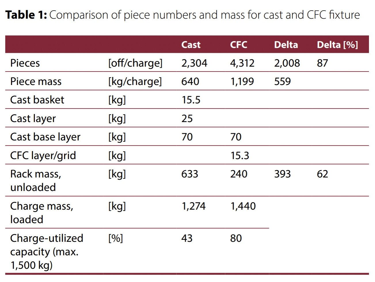

The CFC system produced is shown in Fig. 3. Compared with
the cast variant, the number of pieces can be increased from
2,304 to 4,312, namely by 87 % (Table 1).
The slim design reduces the dead mass by 393 kg. In this way, depending on the components, there is a 60 % reduction in fixture weight and this enables a larger number of pieces (packing density). The weight of the CFC fixture includes a cast base tray (70 kg). It should be noted that, due to the advantageous CFC material properties, an optimization of the cast design (baskets) was not considered. The batch volume is calculated according to the maximum weight of 1,500 kg of the furnace. The comparison between cast and CFC clearly shows that for this drive component (piece * component mass) 80 % of the furnace capacity are useable thanks to the CFC design. This corresponds to almost twice (87 %) the batch volume.
