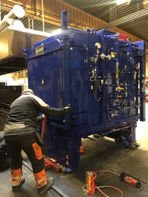

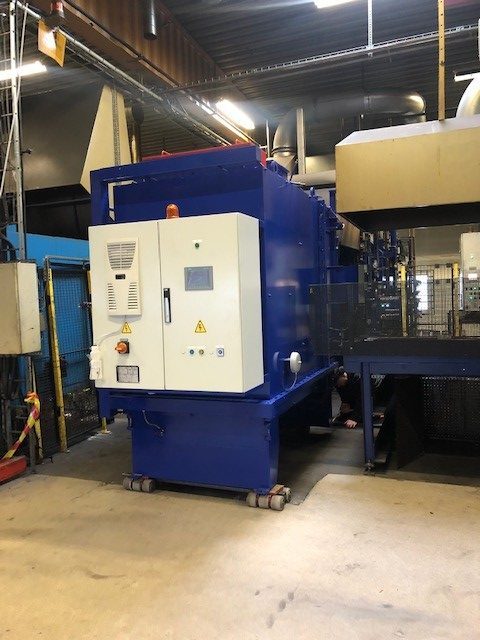

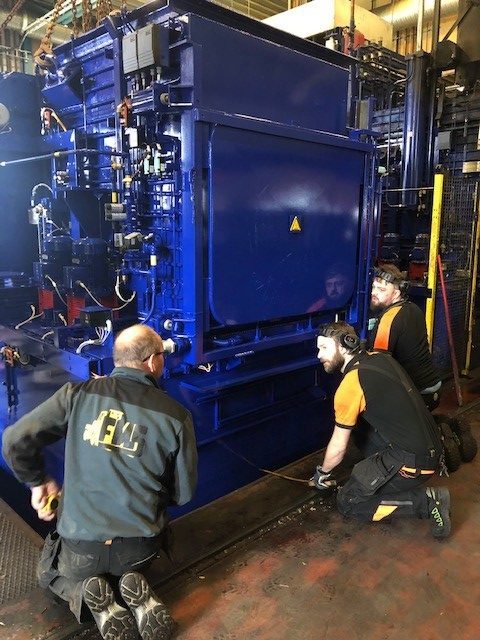

We bought a new RTQ size 10 furnace, a new tempering DC-10 furnace with protective atmosphere and we decided to replace the old loading/unloading car with a new one. All 3 machines were manufactured by Ipsen, who also provided the rest of the line. Our line is very long (40 meters) and really wide, so we ordered a custom-made unloader to fulfil our standards.

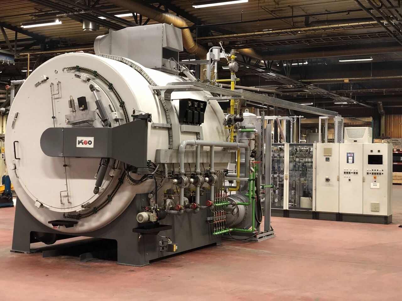

After we sold the old belt furnaces we did overhaul 2000 square meters in the oldest part of the plant, fixed the ventilation system, cleaned walls and painted them, filled old oil pits and installed a KGO gas nitriding furnace. This is a new process for us in Värnamo, but our colleagues in Anderstorp are experts in this area and their training and support is extraordinary. This is just one of the benefits of being part of the Aalberts Group, investments, growth and knowledge is limitless. Mirko Dandic, Plant Manager”
