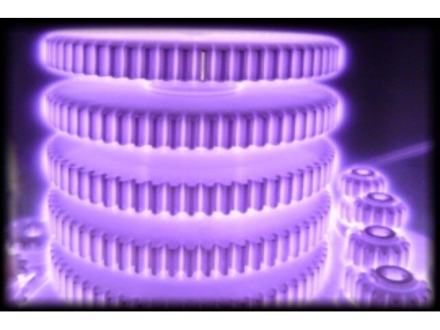

What advantages does pulsed plasma ion nitriding technology present to the aluminum extrusion company and in particular to the die maker whose responsibility it is to both manufacture and maintain the particular extrusion die.
1.0). The process temperature can be reduced to accommodate both temperature sensitive steels as well as geometrically sensitive tool designs.
2.0) The process temperature ramp up to the operational temperature can be preprogrammed without unnecessary gas consumption. This is simply because the whole system is at a negative pressure condition within the process vessel
3.0) Low energy consumption in both process gas and plasm energy.
4.0). Pre-cleaning of the die is accomplished by what is known as sputter cleaning, which can be likened to that of atomic shot blasting.
5.0). The process uses only environmentally friendly, and nonpolluting gases.
6,0). Lower operating costs in spite of a higher capital investment as opposed to gas nitriding or salt bath nitriding.
7.0). No effluent.
8.0). Minimal maintenance procedures necessary.
9.0). Lower operator costs because the process is controlled by PC PLC systems. However, there is still the operator costs for loading and unloading the process chamber.
10.0). The system can be successfully integrated into a production line without any offensive smells which can arise from ammonia gas nitriding.
11.0). Better metallurgical control and a better case formation and case uniformity.
12.0) Process temperature control records the component part temperature rather than the vessel temperature necessary in the process of gas nitriding.
13.0. Overheating which was previously a problem on plasma nitriding before the use of pulsed technology can now be eliminated, simply because of the voltage control, Pulse duration, and Pulse repetition.
14.0). By the introduction of a very small amount of methane to encourage the formation of an epsilon nitride compound layer, the die life can be extended dramatically than with conventional methods of nitriding.
