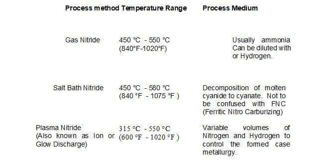

The next illustration shows the process techniques of nitriding with the process mediums and the operating temperature range
